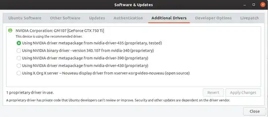

Here is my current graphics card driver:
(base) kevin@kevin-desktop:~$ ubuntu-drivers devices
== /sys/devices/pci0000:00/0000:00:02.0/0000:01:00.0 ==
modalias : pci:v000010DEd00001380sv00003842sd00003753bc03sc00i00
vendor   : NVIDIA Corporation
model    : GM107 [GeForce GTX 750 Ti]
driver   : nvidia-driver-390 - distro non-free
driver   : nvidia-driver-430 - distro non-free
driver   : nvidia-340 - distro non-free
driver   : nvidia-driver-435 - distro non-free recommended
driver   : xserver-xorg-video-nouveau - distro free builtin
Recovery mode boot shows that it's using the latest driver driver

See this answer:
https://askubuntu.com/a/1183357/976775
Notable, you are installing the 435 driver, I found this driver still had issues, I had to go back to the 430 driver specifically to resolve the issue.
I disregarded the "auto-login" step at first, but this is actually a crucial step. It seems to log your account in automatically and when trying to login again it gets stuck.
