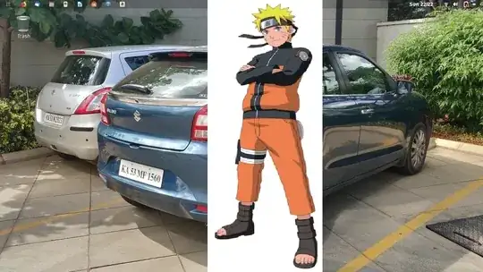

In Desktop mode, the transparency is there on status bar
screenshot, desktop mode

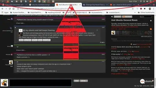

However, Status Bar Transparency does not persist when any app is opened in maximized mode
screenshot, maximized mode
