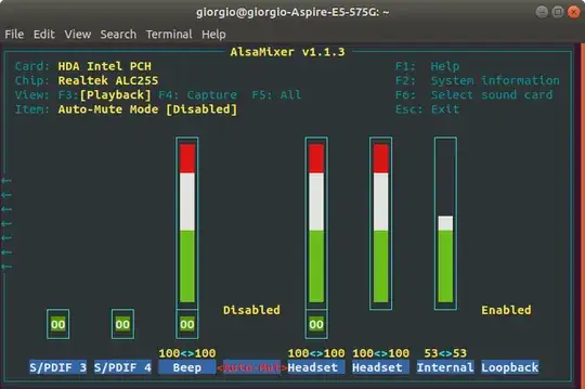

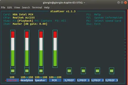

For those who have this problem, if the solutions in other similar questions won't work, like using pavucontrol etc., perhaps you need, like in my case, to look in alsamixer if you have auto-mute enabled by scrolling right in the alsamixer playback units, because if it's enabled it is not sufficient to raise the volume of your speaker from the alsamixer to solve the problem. So step one make sure volume of playback unit is not muted.
And STEP TWO make sure that auto-mute is disabled.
