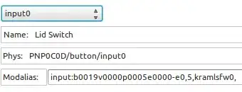

I have a SAMSUNG laptop, which by the experience in the last months, has been a great one. I am actually implementing some functionality to it, and since I noticed, I am able to wake up my laptop from sleep by just opening the lid on Windows 7, however, I need to press to power button to wake up in Ubuntu. Using a program called i-nex, I noted that the kernel DOES dettect a "lid switch", and I am looking forward to use it to wake up function. Any ideas?

Still, there is /proc/acpi/button/lid/LID/state file which shows that LID is opened. Any more ideas?
