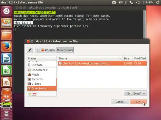

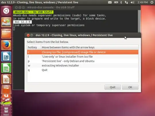

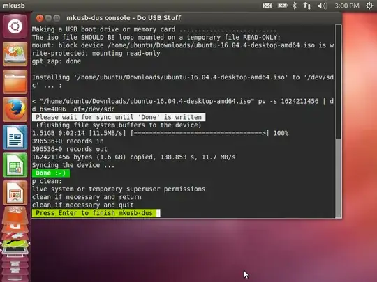

Clone from the Ubuntu 16.04.4 LTS iso file to the USB drive. You can use mkusb (via PPA). See the following links for details,
Some screenshots along the way:
