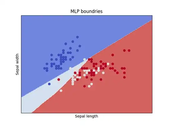

If instead you still want to stick with mlp, then something that you could do to better understand your model is plotting the decision boundaries learned by it. Sklearn has a nice tutorial on how to do it, I copied it and changes the svm with an mlp just to show that the approach works regardless of the model

The code output this plot: enter image description here
Your can see that the boundaries are a crude approximation of the mlp behavior, they are just estimated from a brute force prediction applied to all points of the 2D graph generated by 2 features of the input data. SO the boundaries will change depending also on the features you decide to plot. But it gives you an idea about the relationships learned by the mlp.
